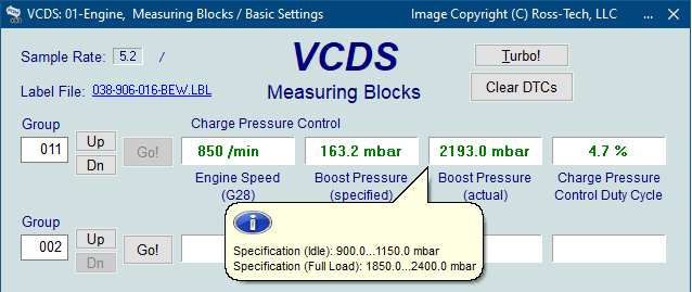

Label Files also allow a third label field to be defined for each of the normal measuring block fields. This label is displayed in a balloon when the user hovers over a field. The idea is to put "specified values" in this field:
