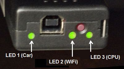

6.6a What do the 3 LEDs on the HEX-NET indicate?
LED
1 (Car): Solid Green: Car side of interface is
powered up and K-Lines OK. Flashing Red/Off is indicative of
a stuck K-Line (in which case the HEX-NET will also produce an audible
alarm). This LED will alternate Red/Green when
interface is communicating with car. If this LED
is off, there is no power from the car and communications with the car
are not possible.
LED 2 (WiFi): Orange: HEX-NET is in Access Point Mode. Access it directly by connecting your
device to the WiFi network with the same name as the serial number on
the HEX-NET's label. No internet access is possible in this mode.
Flashing Red : The HEX-NET is in Infrastructure Mode and trying to connect to the specified network.
Solid Green: The HEX-NET is in Infrastructure Mode and is connected to the specified network.
LED 3: (CPU): Flashing
Green indicates normal CPU activity. Red indicates the CPU is busy. No activity at all (off or any color solid for more
than 5 seconds) indicates a that the HEX-NET has crashed and needs to be powered off an back on. This should never happen. ;-)
