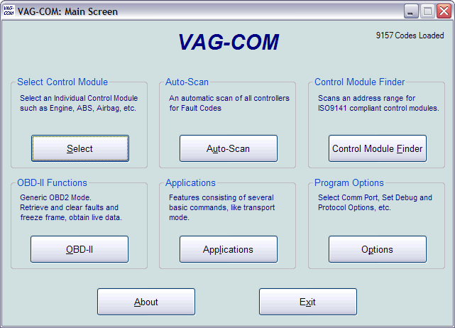

This is an HTML simulation built from actual screen-shots of the latest version of VAG-COM.
This screen appears when you start VAG-COM by clicking the shortcut on your Desktop or by selecting VAG-COM from the Start Menu.
On this screen, you have 8 buttons that you can click with your mouse:
[Select]
[Auto-Scan]
[Control Module Finder]
[OBD-II]
[Applications]
[Options]
[About]
[Exit] (This closes the VAG-COM program)
In the actual VAG-COM program, all buttons except Options and About will be grayed-out until you have Saved your Options settings.
Click on the buttons in the screen shots to "navigate" through this manual.
You can also use the "Manual Index" below (scroll down).
If you're trying to figure out how to Register/Activate VAG-COM, click on the [About] button.
To go back to the Ross-Tech Home Page, click the [Exit]  button
Note: Shareware limitations are shown on the bottom of each page in this manual..
