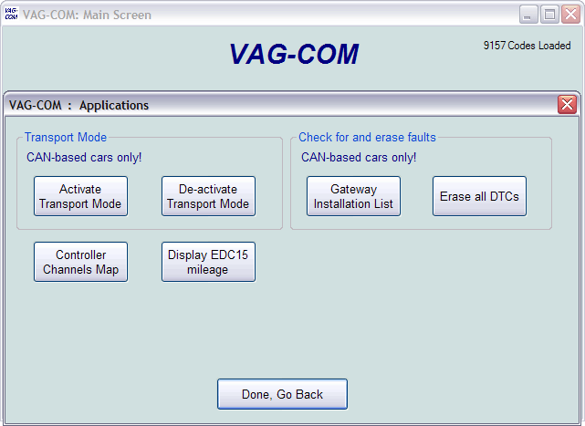

                Online Demo / Manual - Applications Screen
Clickable Area Clickable Area Clickable Area Clickable Area
Transport Mode
On vehicles using CAN for diagnostics, there is a special Transport Mode that is used by the factory to put the cars into a "sleep" to conserve battery charge during long periods of inactivity.
[Activate Transport Mode]
Clicking this button will put applicable vehicles into Transport Mode, shutting down most systems.
[De-activate Transport Mode]
Clicking this button will "wake up" applicable vehicles from Transport Mode, powering up most system.
Check for and erase faults
[Gateway Installation List]
Only available only on Gateways in cars using a direct CAN connection for diagnostics (like the new A8 and all Golf-5 chassis cars).  This very fast function takes about 3 seconds to query the car's Gateway to find out what modules are installed in the car and what their status is.   Any modules having fault codes should show a "Malfunction".    Modules are directly accessible from this screen by double clicking on the appropriate line.   The following screen-shot is from a Golf-5 in Europe:
Clickable Area Clickable Area Clickable Area Clickable Area Clickable Area Clickable Area
[Erase All DTCs]
On vehicles using CAN for diagnostics, VAG-COM performs this function without accessing all the control modules individually.

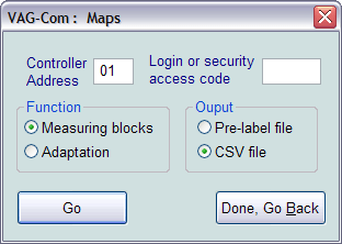

[Controller Channels Map]
Rapidly scans through all 255 possible Measuring Block groups or Adaptation Channels on any ECU and writes a "map" file.   Output is your choice of .CSV  or .PLB ("Prototype Label, Blocks").   Useful for creating new label files or taking a "snapshot" of all available data from an ECU.

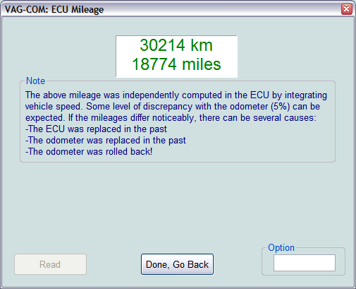

[EDC-15 Mileage]  On some (but by no means all) TDI ECUs, VAG-COM can show an independent "odometer" reading stored in the ECU. This can useful as a means of cross-checking the mileage on used car at time of purchase, particularly in Europe where odometer fraud is rampant. We plan to extend this functionality to as many ECUs as practical in the future.
