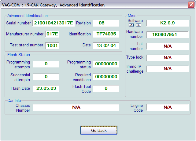

Advanced ID Screen
Corresponds to VAS-5051/5051 "Identification Services"
The Advanced ID function is only supported by control modules using the KWP-2000 and CAN Protocols!
Note:  The amount of data appearing on this screen will vary based on what the control module supports.   "N/A" in red means that data isn't available from that module.   Some fields (like Chassis Number) may be blank if the module has never had a chassis number "installed".
You can use the small [<] and [>] buttons under Software to get version information for various portions of the firmware in the control module.
Use [Go Back] to return to the Open Controller screen.
Shareware Limitation(s):  None
