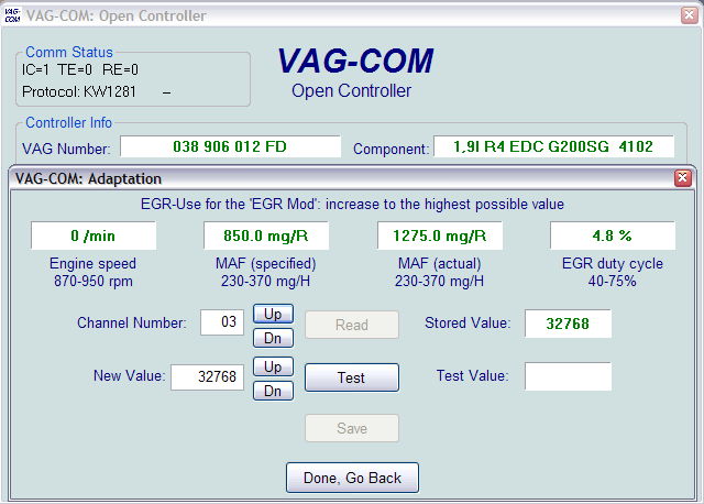

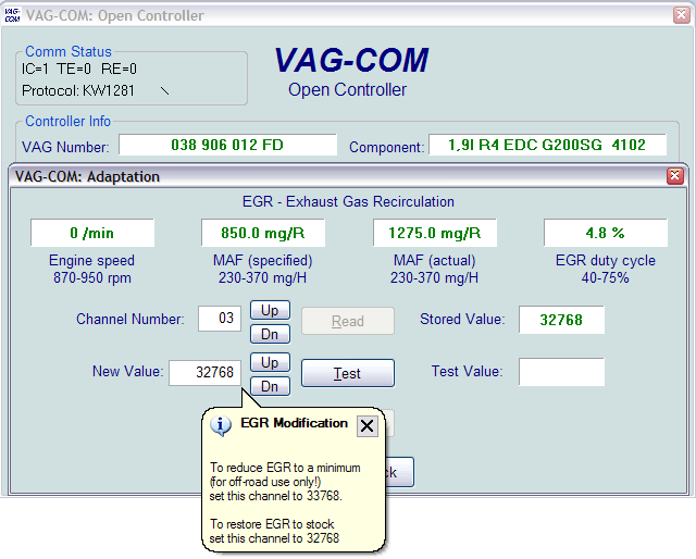

            Allows Labels to be defined for Adaptation
            Channels.   These are displayed with each adaptation
            channel:

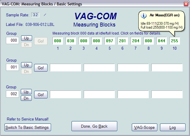

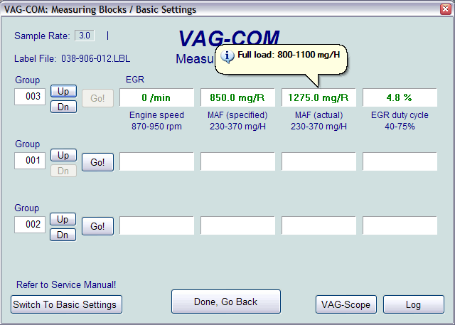

            Allows Labels to be defined for Measuring Block
            000.  Due to space constraints on the screen, these labels
            are displayed in a "balloon" when the user clicks on a field:
            Allows a third label field to be defined for
            each of the normal measuring block fields.   This label is
            displayed in a balloon when the user clicks on the field.  The idea is to
            put "specified values" in this field:

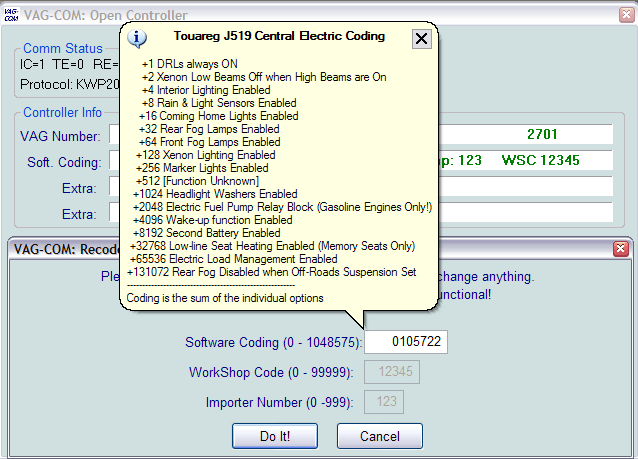

            Allows Coding Charts to be included in
            Label Files.  Up to 20
            lines of coding data can be included in a Label File.
            This data is shown in a balloon on the coding screen (if VAG-COM is
            fully registered/activatated).

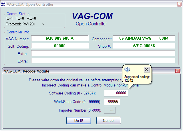

            When coding new Airbag Modules in many VW
            models, VAG-COM can "Suggest" an appropriate Coding value.
            This feature is available only
            when VAG-COM is used with one of our
            Professional Grade interfaces.
            Disclaimer:  We cannot guarantee that the coding which VAG-COM
            may suggest will be correct, but there should be no harm in trying
            it.  If it's not correct, the control module should simply
            refuse to accept it and the coding will remain at 00000.

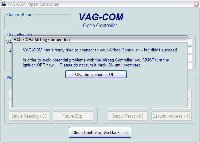

            In addition, if VAG-COM has any difficulties connecting to the
            airbag, you may see a screen like this.  If you see this
            screen, please do exactly what it tells you!
