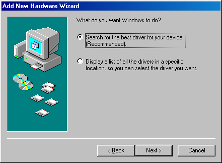

  2. The Add New Hardware Wizard should give you the following choices:
    in this dialog, select "Search for the best driver for your device" then click
     [ Next > ].

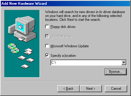

  3. The Add New Hardware Wizard should give you the following choices:
    in this dialog, ensure that only "Specify a location:" is checked, then click the [ Browse... ] button.

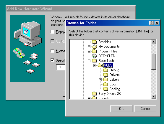

  4. A Browse for Folder dialog should appear:
    In this dialog, please browse to the location where you've installed VCDS, typically C:\Ross-Tech\VCDS.
    Once you've highlighted the location where you've installed VCDS, the [ OK ] button should become enabled.
    Click the [ OK ] button.

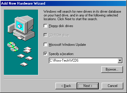

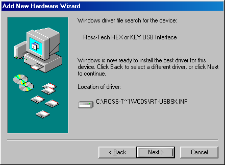

  5. You will then return to the Add New Hardware Wizard and the specified location will be filled in for you.
    Click the [ Next > ] button.
  6. The following dialog should appear:

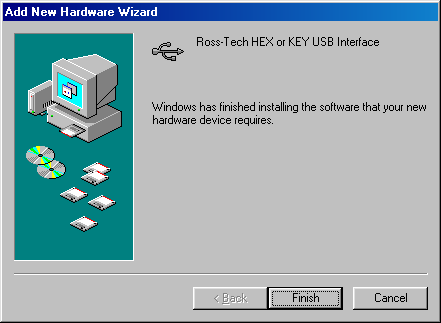

  7. The following dialog should appear:
    Click the [ Finish ] button.

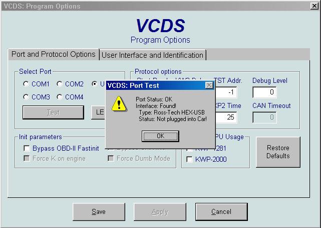

  8. Start VCDS and go to the [ Options ] screen.
    Select the USB Port.
    Click the [ Test ] button.
    The results should look like this:
