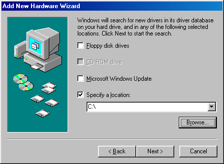

  3. The Add New Hardware Wizard should give you the following choices:
    in this dialog, ensure that only "Specify a location:" is checked, then click the [ Browse... ] button.

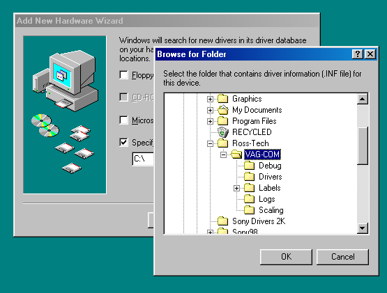

  4. A Browse for Folder dialog should appear:
    In this dialog, please browse to the location where you've installed VAG-COM, typically C:\Ross-Tech\VAG-COM.
    Once you've highlighted the location where you've installed VAG-COM, the [ OK ] button should become enabled.  Click the [ OK ] button.

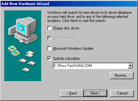

  5. You will then return to the Add New Hardware Wizard and the specified location will be filled in for you.
    Click the [ Next > ] button.

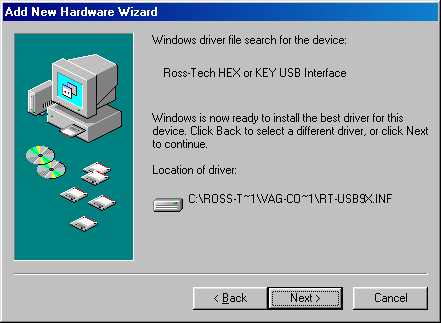

  6. The following dialog should appear:

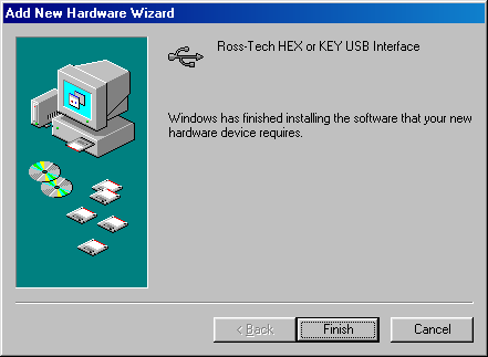

  7. The following dialog should appear:
    Click the [ Finish ] button.
