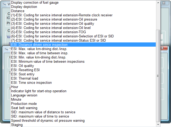

    Channel numbers are history.  Instead, the item to be changed is selected from a drop-down box:
    Note:  Due to variations between control modules within a single type, not every channel listed will exist in every control module of that type.   If you select a channel which doesn't exist, you'll get an "Channel N/A" instead of a Stored Value.

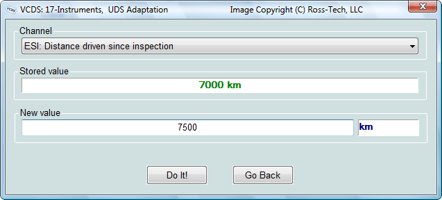

    Once you've selected a channel which does exist, you can enter a new value:

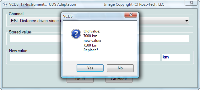

    When you click [Do It!], you'll be asked to confirm:
    After you confirm the action, you'll be told whether the control module accepted or rejected the New Value.

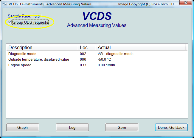

  • Advanced Measuring Values on UDS modules now has a "Group UDS Requests" option which can substantially increase the sample rate when looking at multiple values:
    Each control module will have a limit on how many requests can be grouped.   Unfortunately, there does not appear to be a way to tell in advance what that limit is.   If you try to group too many requests, it simply won't work.

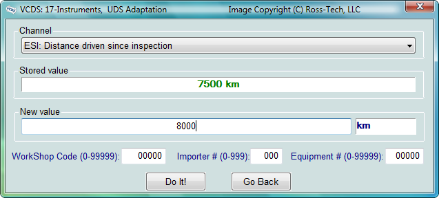

  • Added WSC, Importer and Equipment Number fields to the UDS Adaptation screen.
    Based on our in-house testing we had thought this wasn't necessary but field testing has demonstrated that it is.   These fields will be enabled only when actually needed:

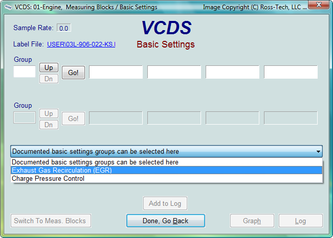

  • New Drop-Box for selecting documented Basic Settings Groups.    This allows quick select selection of Basic Settings Groups by Function if they are documented in the Label File for a particular control module:
