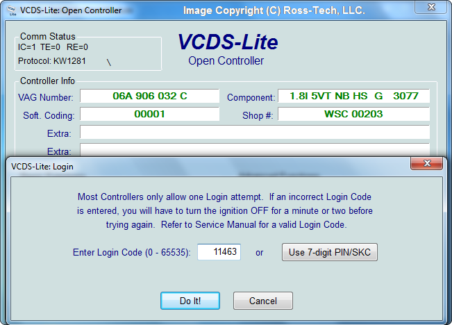

The Login
                  Function must be used on some (but not all) Control Modules
                  before you can Recode or change Adaptation values. On others,
                  it "enables" certain features like cruise control. Valid Login
                  codes can be found in the Factory Repair Manual for your car.
                  If the label file for the controller contains suggestions,
                  they may appear in a balloon.
                  If working
                  on an Immobilizer, select
                  [Use 7-digit
                  PIN/SKC] to enter a 7-digit Secret Key Code.
                  Use the
                  [Do It!] button to save the Login and return to the Select
                  Function Screen.
                  Use the
                  [Cancel] button to cancel the Login and return to the Select
                  Function Screen.
                  A "Login lost due to dropped session" warning
                  appears in the upper right corner of the screen if a session
                  is disconnected after you have unsuccessfully tried a Login.
                  You will need to do another Login.
                  The most common cause of this is the use of an
                  incorrect login code or a 7-digit PIN/SKC based on an
                  incorrect Immobilizer ID or incorrect data entered in the
                  7-digit dialog.
