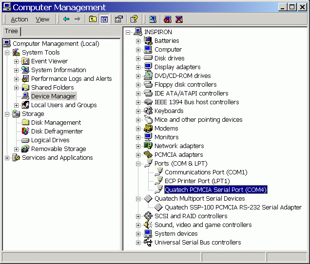

order to change the COM port number that is assigned to the SSP-100,
go to bring up Device Manager on your PC. It will look something

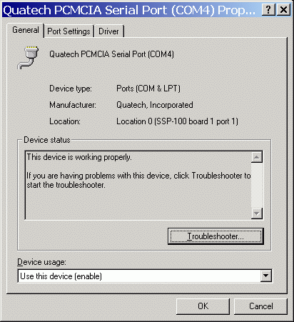

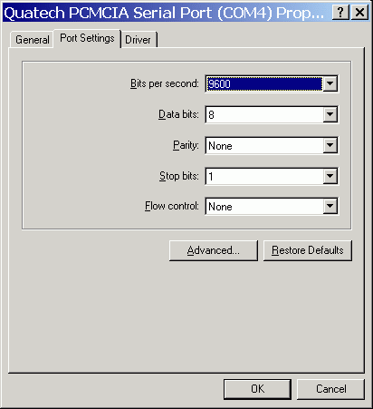

like this: If you look under Ports (COM & LPT) you should find the port assigned to the Quatech PCMCIA Serial Port . If it is higher than COM4, double-click on it. A dialog that looks like this will appear:
Now click on the Port Settings tab at the top. The dialog will change and look like this:

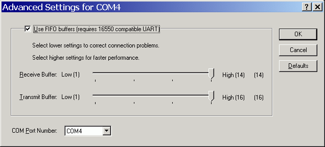

Click the Advanced button. A new dialog that looks like this will pop up:
At the
bottom of this dialog, you can select the COM port number that is
assigned to the Quatech port. If a number lower that 5 is
available, select it. If no number lower than 5 is
available, you will have to make some hardware configuration changes
on your PC -- essentially disabling or re-arranging other devices on
your PC. Unfortunately, the process for doing this varies
greatly from one make/model of PC to another and we can't possibly
document it. Please consult the documentation supplied

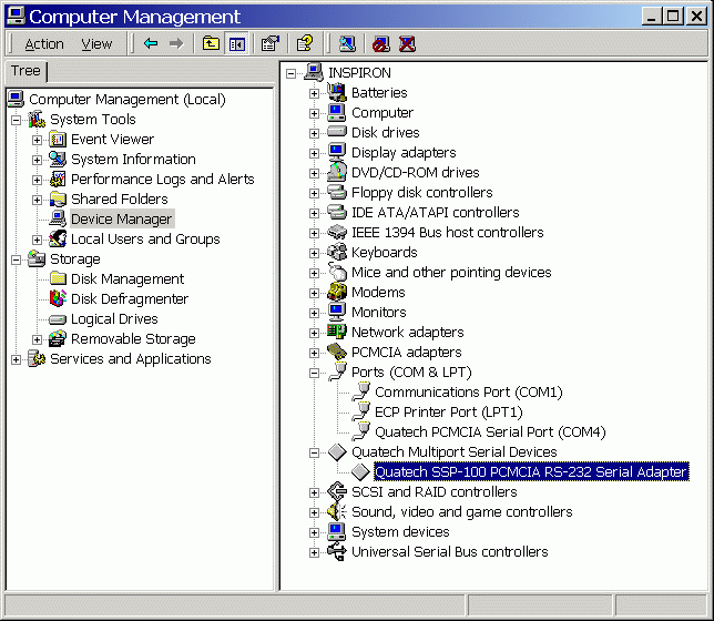

with your specific PC. Quatech SSP-100 boards shipped since the end of May 2002 have a special high-speed feature that is not applicable to VAG-COM. Having it selected sometimes prevents VAG-COM from synchronizing with some control modules in some cars, resulting in "Cant' Synch Baud Rate" messages when accessing some controllers. To fix this problem, you need to start at Device Manager:

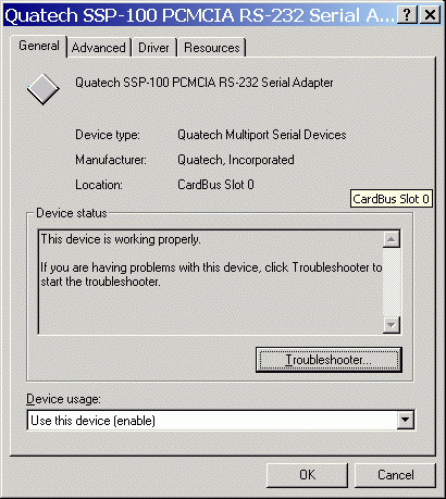

If you look under Quatech Multiport Serial Devices you should find the Quatech SSP-100 PCMCIA RS-232 Serial Adapter. Double-click on it and the following dialog should appear:

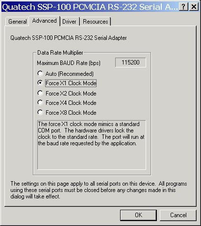

Here, you need to click on the Advanced tab at the top. The dialog will then change and look like this:
Here, you will see the default setting of Auto selected. This doesn't seem to work correctly at some baud rates. You must change the Data Rate Multiplier to Force X1 Clock Mode. That will cure the "Cant' Synch Baudrate" problems that VAG-COM encounters on some control modules with the latest generation of these cards. Note: We have reports from some users
that the Data Rate Multiplier may change itself from "Force X1 Clock
Mode" to the default "Auto" when the PC is rebooted. Quatech seems to
