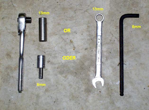

Tools needed:

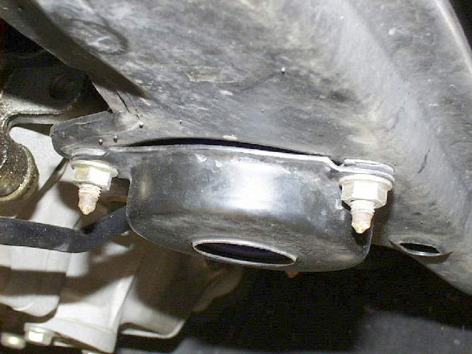

NOTE: The engine does not need to be supported during this procedure. The lower front mount does not support the motor, it only controls motion. If the car is at close to standard ride-height, it is not even necessary to raise the car. If you do raise the front of the car, raise both sides evenly to prevent misalignment of the mount. Locate the front lower mount under the car, in the middle. It looks like this:

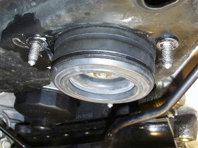

The cover is attached with three nuts. You can only see two of the nuts in this picture. Use a 13mm wrench and remove all three nuts, then remove the cover. You will then see this:
Now remove the bolt in the middle of the original mount using an 8mm Allen wrench. Then remove the original mount. On the next page, we'll install the Turn2 Mount.
