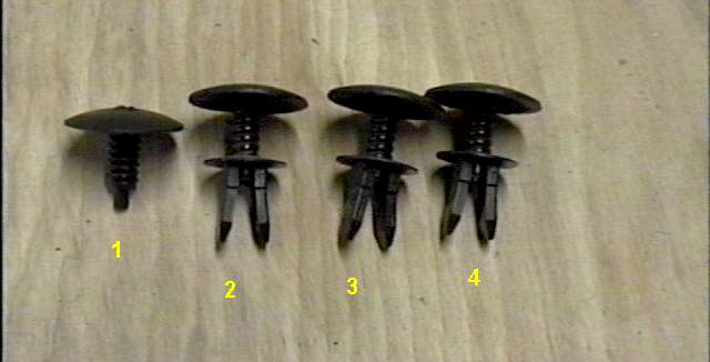

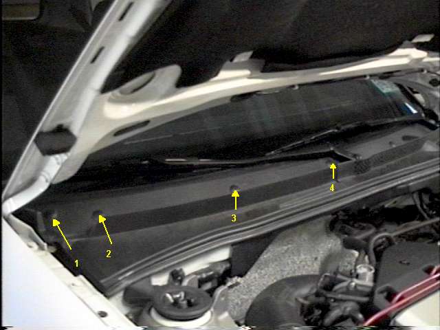

It is necessary to remove these 4 "screws".   Number 1 is a real screw and can be removed in the usual manner.
Numbers  2, 3 and 4 are "screw clips", and they are somewhat more difficult to remove.
The best thing is to pry upwards on their heads while turning them with a screwdriver at the same time.   This is probably the hardest part of the entire job.   Don't give up!  You'll get them out eventually.

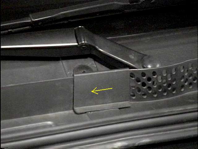

After all four fasteners have been removed,  slide the clip in the middle in the direction indicated by the arrow.
