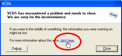

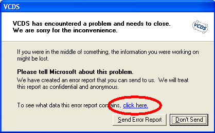

In very rare instances, some
users may experience a VCDS "Crash". In
that case, one of the following
dialogs will typically appear:
or
or, under Vista:

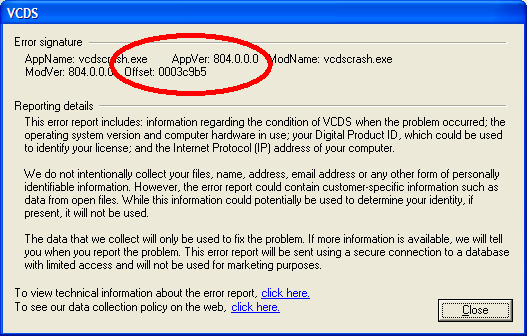

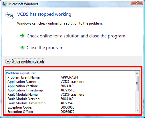

Starting with Beta 804.0,
if you are presented with this dialog, you can help us find the
cause of the problem by providing us with data associated with
the crash. Please click the "click here" or "View
problem details" link circled in red
in the above dialogs to
see the data. You will then see a dialog resembling one of
these two:
or, under Vista:
(you may only get the "Error
signature" portion of the dialog).
Ideally, we would like a complete
screenshot of this dialog, but should this not be
possible, please give us the contents of the AppName, AppVer,
ModName, ModVer and Offset fields (Application
name/version, Fault Module name/version, Exception code/offset
for Vista).
