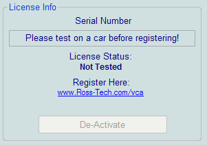

If you do not see a Serial Number, but instead see a message that says:
... then you need to TEST VAG-COM as described in our FAQ.

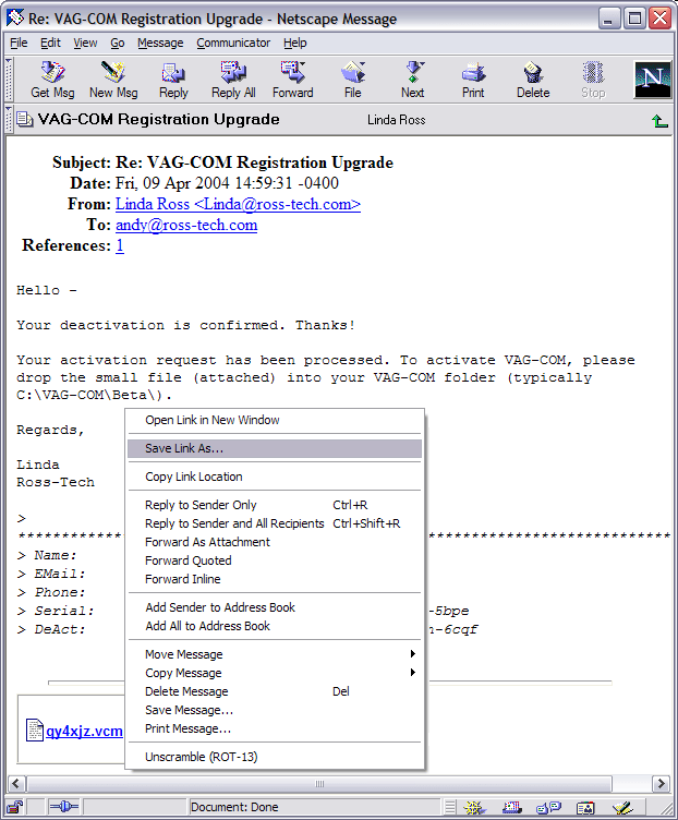

Saving the Activation File
Once you receive the email with Activation File, make sure that the Serial Number in the email still matches the Serial Number as shown on the About Screen in VAG-COM. Use your email program to save the attachment as shown in the examples below. If your email program does not display the file as an attachment (may happen with Hotmail accounts), reply to the email and ask for further instructions.
- OR -
Save the attached Activation file to your C:\Program Files\VAG-COM folder as shown below:
(Make sure the "Save as type:" field at the bottom shows "All Files (*.*)"
(The above examples use Netscape Messenger and Microsoft Outlook email programs. Consult the documentation for your email program for assistance with saving attachments)
